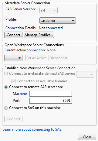

To begin, select File > SAS > Server Connections. The SAS Server Connections window shown in Figure 2.14 appears. All connections are made in this window.
Figure 2.14 SAS Server Connections

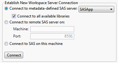

Figure 2.15 Open a Connection to a Workspace Server
3.
Click Connect.

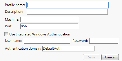

Click Manage Profiles.
3.
Click Add to add a new profile, or click Modify to change a profile’s settings.
Figure 2.17 Create or Modify a Metadata Server Profile
5.
Click Save.

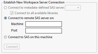

Figure 2.18 Open a Connection to a Remote SAS Server
4.
Click Connect.
