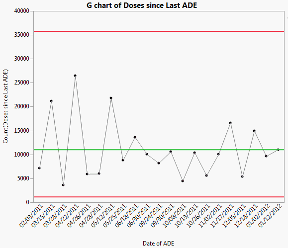

Select Help > Sample Data Library and open Quality Control/Adverse Reactions.jmp.
2.
Select Analyze > Quality and Process > Control Chart Builder.
3.
Drag Doses since Last ADE to the Y role.
4.
Drag Date of ADE to the Subgroup role.
5.
To change the chart to a Rare Event chart, select Rare Event from the drop-down list.
Figure 2.23 g-chart of Doses since Last ADE
