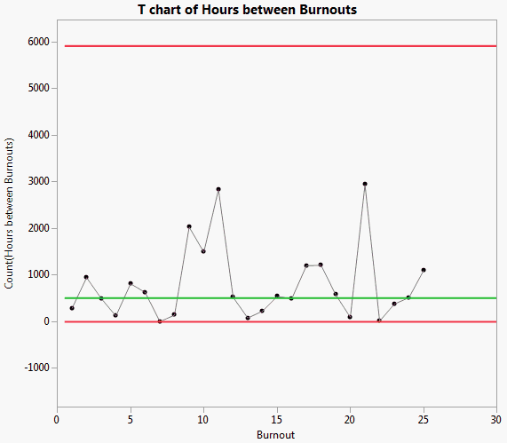

6.
Change the Sigma from Negative Binomial to Weibull to change the chart to a t-chart.
Figure 2.25 t-chart of Hours Between Burnouts
