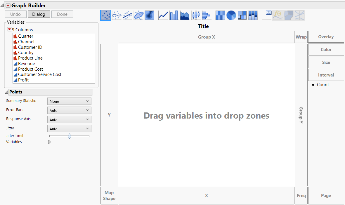

Select Graph > Graph Builder.
Figure 2.69 Graph Builder Workspace

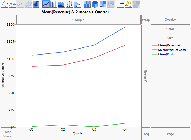

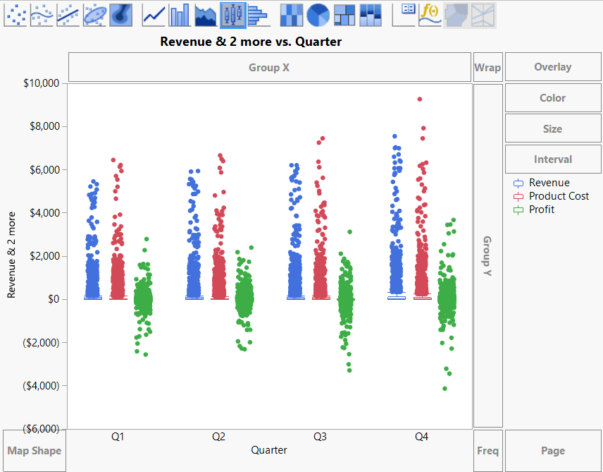

3.
Click Quarter and then drag and drop it onto the X zone to assign Quarter as the X variable.
4.
Click Revenue, Product Cost, and Profit, and drag and drop them onto the Y zone to assign all three variables as Y variables.
Figure 2.70 After Adding Y and X Variables
Figure 2.71 Line Plot

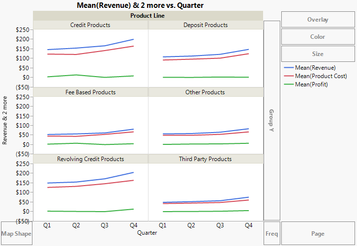

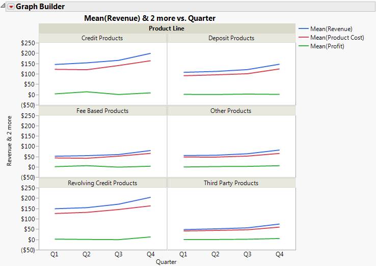

6.
To create a separate chart for each product, click Product Line, and drag and drop it into the Wrap zone.
Figure 2.72 Final Line Plots
Figure 2.72 shows revenue, cost, and profit broken down by product line. The business analyst was interested in seeing the difference in profitability between product lines. The line plots in Figure 2.72 can provide some answers, as follows:

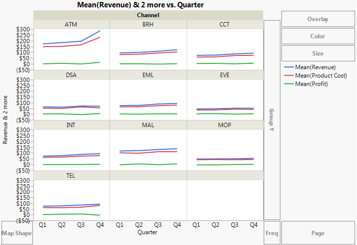

2.
To add Channel as the wrap variable, click Channel and drag and drop it into the Wrap zone.
Figure 2.73 Line Plots Showing Sales Channels
Figure 2.73 provides this answer: revenue and product cost for ATMs are the highest and are growing the most quickly.
