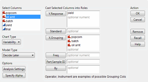

Select Analyze > Quality and Process > Variability/Attribute Gauge Chart.
3.
Select yield and click Y, Response.
4.
Select popcorn and click X, Grouping.
5.
Select batch and click X, Grouping.
6.
Select oil amt and click X, Grouping.

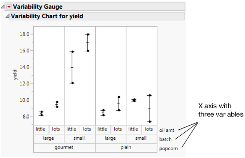

Note: The order in which you assign the variables to the X, Grouping role is important, because the order in this window determines their nesting order in the variability chart.

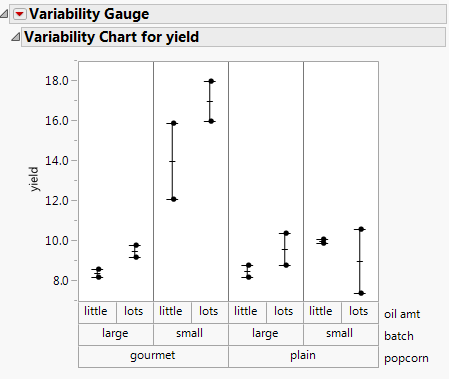

7.
8.
Deselect Std Dev Chart on the red triangle menu.
