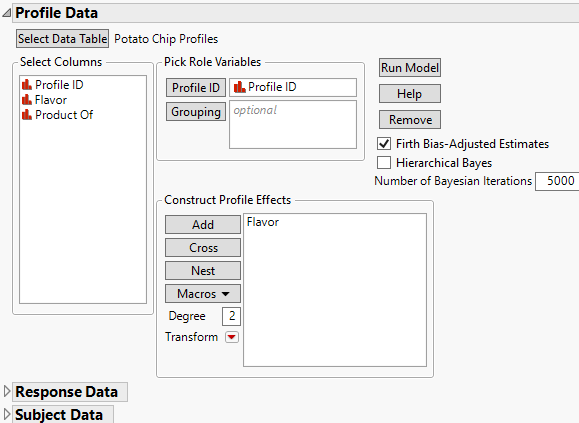

Figure 5.10 shows the multiple-table launch window, with the Profile Data outline populated using Potato Chip Profile.jmp.
Figure 5.10 Launch Window for Multiple Tables, Cross-Referenced Data Format
Identifier for each row of choice combinations. If the Profile ID column does not uniquely identify each row in the profile data table, you need to add Grouping columns. Add Grouping columns until the combination of Grouping and Profile ID columns uniquely identifies the row, or profile.
A column which, when used with the Choice Set ID column, uniquely designates each choice set. For example, if Profile ID = 1 for Survey = A, and a different Profile ID = 1 for Survey = B, then Survey would be used as a Grouping column.
Hierarchical Bayes
Number of Bayesian Iterations

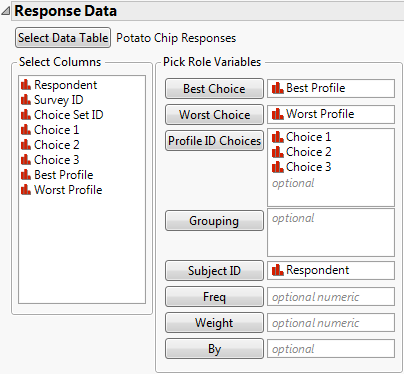

Figure 5.11 shows the Response Data outline populated using Potato Chip Responses.jmp.
Figure 5.11 Response Data Outline
The columns that contain the Profile IDs of the set of possible choices for each choice set. There must be at least three profiles.
A column which, when used with the Profile ID Chosen column, uniquely designates each choice set.
A column containing frequencies. If n is the value of the Freq variable for a given row, then that row is used in computations n times. If it is less than 1 or missing, then JMP does not use it to calculate any analyses.

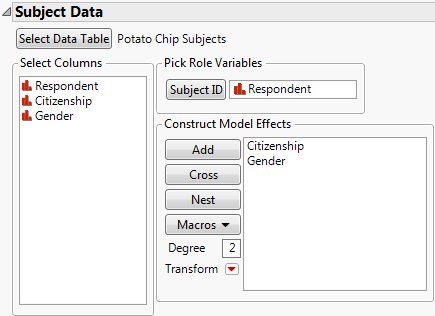

Figure 5.12 shows the Subject Data outline populated using Potato Chip Subjects.jmp.
Figure 5.12 Subject Data Outline
