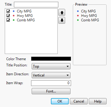

To move the position of the legend, click the Graph Builder red triangle and select Legend Position. The legend appears on the right by default, but you can move it to the bottom of the graph, or inside the graph on the left or right.
Figure 2.45 Example of the Legend Settings Window Using Hybrid Fuel Economy.jmp
Sets the legend to be n items tall (if vertical) or n items wide (if horizontal).

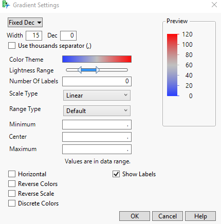

Figure 2.46 Gradient Settings Window
To format the labels in the legend, use the menu, Width and Dec boxes, and the Use thousands separator (,) check box in the top left of the window.
The minimum and maximum values are the 5th and 95th quantiles, or they are the values that you specify as Minimum and Maximum. This option is resistant to outliers.
