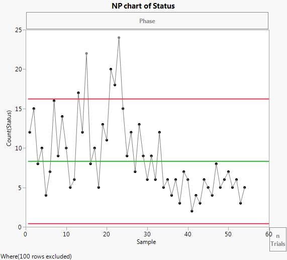

Drag Status to the Y role.
Figure 2.18 np-chart of Status (Nonconforming)

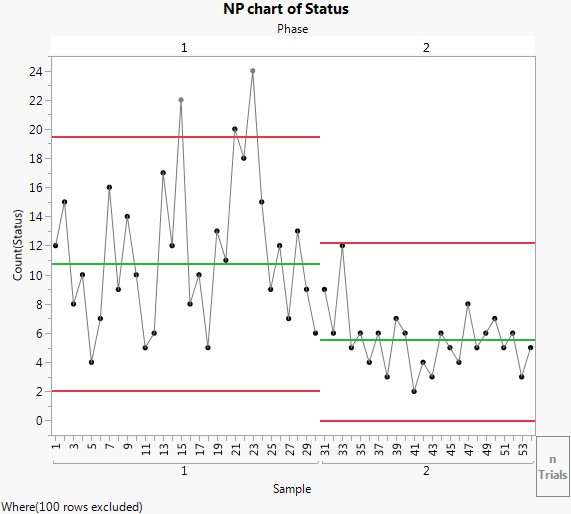

Drag Phase to the Phase zone.
Figure 2.19 np-chart by Phase
Including the Phase variable means that the control limits for phase 2 are based only on the data for phase 2. None of the phase 2 observations are outside the control limits. Therefore, you can conclude that the process is in control after the adjustment.
