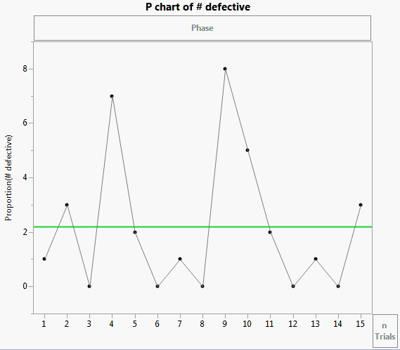

Change the Sigma to Binomial to change the chart to a np-chart.
6.
Change the Statistic from Count to Proportion to change the chart to a p-chart.
Figure 2.16 p-chart of # defective

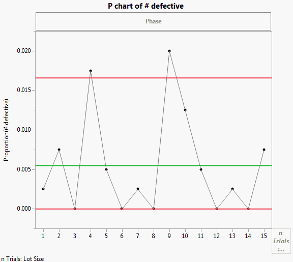

7.
Drag Lot Size to the nTrials role.
Figure 2.17 p-chart of # defective with sample size
To view the differences between constant and variable sample sizes, you can compare charts for Lot Size and Lot Size 2 by simply dragging the variables to the nTrials zone.
