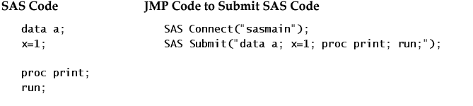

Figure 2.26 SAS Code Submission Example
Note: Use the JSL function As SAS Expr( formula ); to turn any prediction formula into an expression that can be used in a SAS Data Step. See As SAS Expr(x) in the JSL Syntax Reference.
