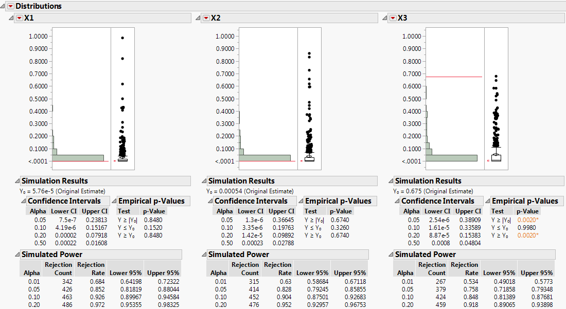

The Simulate option is available in many reports, including all of those that support Bootstrap. To access the Simulate option, right-click in a report.
Figure 10.1
Power Analysis Using Simulate
