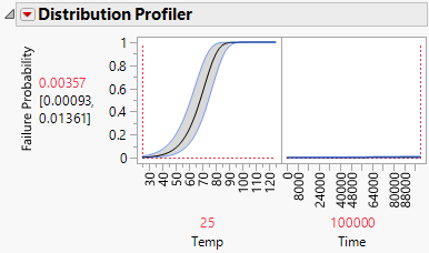

Figure 21.1
Profiler Showing Failure Probabilities for ALT Experiment
