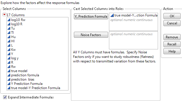

From the Borehole Sphere Packing.jmp data table, select Graph > Profiler.
8.
Select true model-Y Prediction Formula and click Y, Prediction Formula
9.
Select Expand Intermediate Formulas.
Figure 20.26 Profiler Dialog for Borehole Sphere-Packing Data

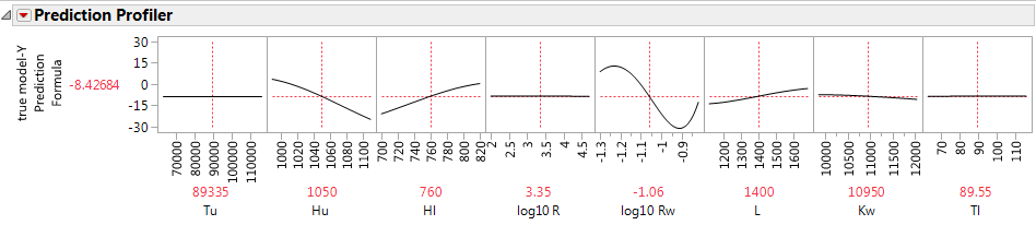

Figure 20.27 Profiler for Bias of the Borehole GP Model with Y axis Set at -30 to 30

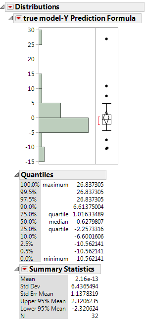

You can use the profiler to explore the range of the prediction bias over the entire domain. To find points of minimum and maximum bias, select Optimization and Desirability > Desirability Functions from the Prediction Profiler red triangle menu. See Desirability Profiling and Optimization in the Profilers book. To evaluate the prediction bias over the design points, select Analyze > Distribution to see a distribution analysis.
Figure 20.28 Distribution of the Prediction Bias
