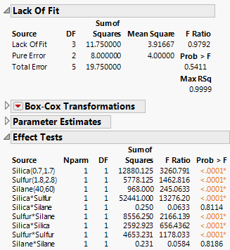

Click Run.
Figure 10.6 Lack of Fit and Effect Tests Reports
There is no indication of lack of fit and the Effect Tests report indicates that all but two higher-order terms (Silica*Silane and Silane*Silane) have p-values below 0.0001. See Lack of Fit and Effect Tests in the Fitting Linear Models book for more information about interpretation of the tables in Figure 10.6.

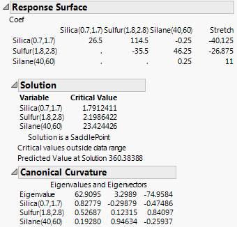

Figure 10.7 Response Surface Report
See Response Surface Model Example in the Fitting Linear Models book for details about the response surface analysis tables in Figure 10.7.
