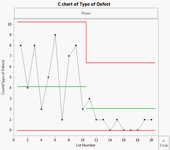

Open the Type of Defect disclosure icon. Note that all of the defect types are listed, but only Bruised veneer is selected and displayed in the chart. You could select additional defect types and the chart would update immediately. Leave it as is for now.
Figure 2.20 c-chart of Type of Defect
7.
To add to phase variable, drag Date to the Phase zone.
Figure 2.21 c-chart of Type of Defect with Phases
