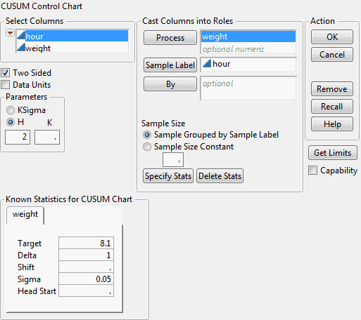

Select Analyze > Quality And Process > Control Chart > CUSUM.
3.
4.
5.
Select the Two Sided check box if it is not already checked.
6.
In the Parameters area, click the H button and type 2.
7.
Click Specify Stats.
8.
Type 8.1 next to Target.
9.
Type 1 next to Delta.
10.
Type 0.05 next to Sigma.
Figure 5.2 Completed Launch Window
11.
Click OK.

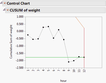

You can interpret the chart by comparing the points with the V-mask. The right edge of the V-mask is centered at the most recent point (the 12th hour). Because none of the points cross the arms of the V-mask, there is no evidence that a shift in the process has occurred. See Interpret a Two-Sided V-Mask CUSUM Chart.
