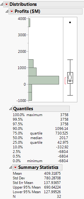

Select Help > Sample Data Library and open Companies.jmp.
2.
Select Analyze > Distribution.
3.
Select Profits ($M) and click Y, Columns.
4.
Figure 6.154 Distribution Report Window

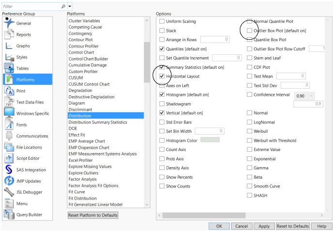

Select File > Preferences (Windows) or JMP > Preferences (Macintosh).
2.
Select Platforms from the preference group.
3.
Select Distribution from the Platforms list.
4.
Select the Horizontal Layout option to turn it on.
5.
Deselect the Outlier Box Plot option to turn it off.
Figure 6.155 Distribution Preferences
