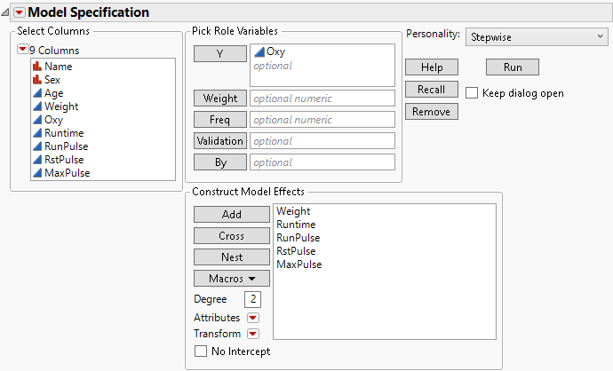

Select Analyze > Fit Model.
3.
Select Oxy and click Y.
4.
Select Weight, Runtime, RunPulse, RstPulse, MaxPulse, and click Add.
5.
For Personality, select Stepwise.
Figure 4.1 Completed Fit Model Launch Window

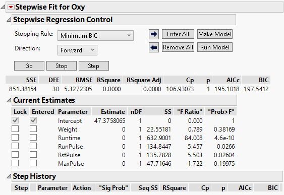

Click Run.
Figure 4.2 Stepwise Report Window
