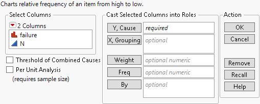

Launch the Pareto Plot platform by selecting Analyze > Quality and Process > Pareto Plot.
Figure 13.5 The Pareto Plot Launch Window
The Pareto Plot launch window contains the following options:
