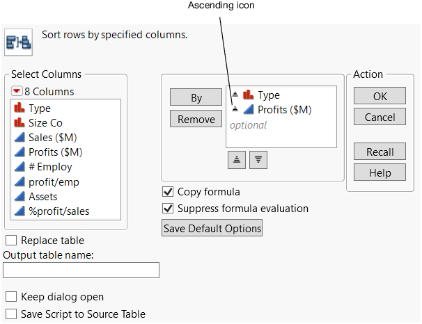

Use the Sort command to sort a data table by one or more columns in the data table. For example, look at financial data for computer and pharmaceutical companies. Suppose that you want to sort the data table by Type, then by Profits ($M). Also, you want Profits ($M) to be in descending order within each Type.
1. Select Help > Sample Data Library and open Companies.jmp.
2. Select Tables > Sort.
3. Select Type and click By to assign Type as a sorting variable.
4. Select Profits ($M) and click By.
At this point, both variables are set to be sorted in ascending order. See the ascending icon next to the variables in Figure 3.29.
Figure 3.29 Sort Ascending IconĀ
5. To change Profits ($M) to sort in descending order, select Profits ($M) and click the descending button.
Figure 3.30 Change Profits to DescendingĀ
The icon next to Profits ($M) changes to descending.
