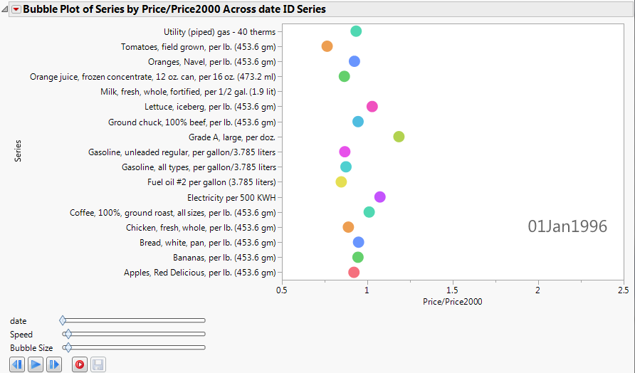

The report window appears. (Figure 5.15 uses the JMP default colors.)
This produces a bubble plot that, when animated by clicking the play button, shows the price bubbles moving side to side according to their price ratio.
Figure 5.15 Static Example of Animated Bubbles
