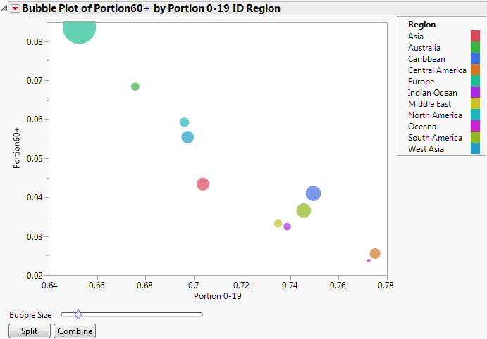

1. Select Help > Sample Data Folder and open PopAgeGroup.jmp.
2. Select Graph > Bubble Plot.
3. Select Portion60+ and click Y.
4. Select Portion 0-19 and click X.
5. Select Region and Country and click ID.
6. Select Region and click Coloring.
7. Click OK.
The initial report window appears. (Figure 5.9 uses the default JMP colors.)
Figure 5.9 Initial Report Window with ID VariablesĀ

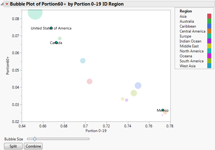

Split the bubble representing the region of North America into countries.
8. Click the bubble representing North America (hover over a bubble to see its label, or use the legend to find the color of North America.)
9. Click Split.
You see that the North America bubble has split into three bubbles, representing the countries within the region of North America (the United States of America, Canada, and Mexico).
Figure 5.10 Splitting the North America BubbleĀ
