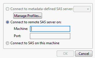

6. In the Connect to SAS Server window (Figure 8.8), choose a method to connect to SAS (if you are not already connected). For this example, select Connect to SAS on this machine.
Figure 8.8 Connect to SAS ServerĀ
7. Click OK.

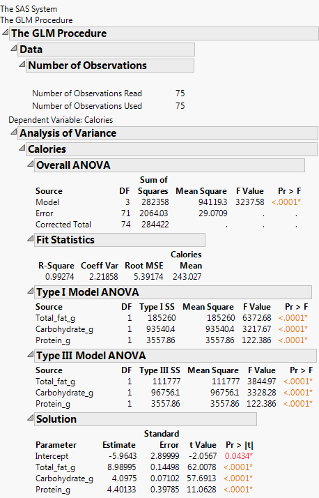

JMP connects to SAS. SAS runs the model and sends the results back to JMP. The results can appear as SAS output, HTML, RTF, PDF, or JMP report format (you can choose the format using JMP Preferences). Figure 8.9 shows the results formatted as a JMP report. See Import Data from SAS in Using JMP.
Figure 8.9 SAS Results Formatted as a JMP ReportĀ
