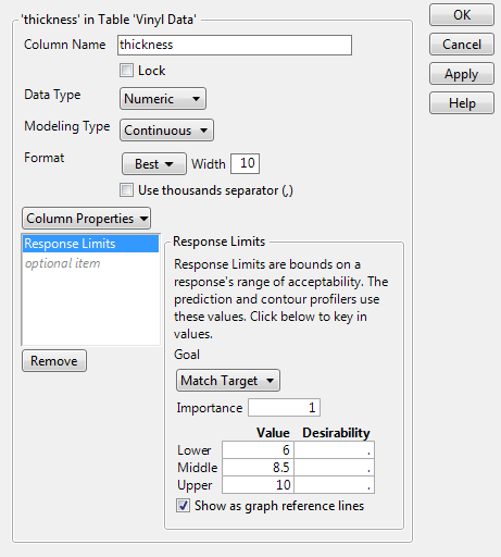

2. Select the thickness column and select Cols > Column Info.
The Response Limits property appears in the Column Properties list as the only property assigned to thickness. The Response Limits panel appears to the right of the list.
3. Click Maximize and select Match Target.
4. Type 1 for the Importance value.
5. Under Value, type 6 for the Lower value, 8.5 for the Middle value, and 10 for the Upper value.
This is an example of asymmetric response limits. Values of thickness as small as 6 or as large as 10 are acceptable. However, the target for thickness is 8.5.
6. Select Show as Graph Reference Lines.
This option shows horizontal reference lines for the Lower, Middle, and Upper values in the Actual by Predicted Plot and the Prediction Profiler.

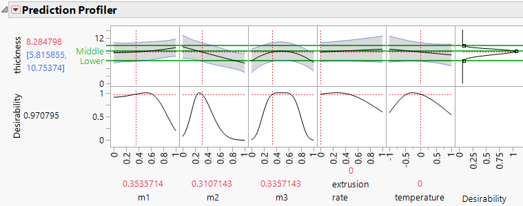

11. Click the Response thickness red triangle and select Factor Profiling > Profiler.
Figure A.9 Prediction Profiler Showing Asymmetric Desirability Function
The plot at the right above Desirability shows the desirability function that JMP has constructed for thickness. The desirability is 1 at the Middle limit of 8.5. The desirability is essentially 0 for thickness values below 6 and above 10.

14. Click the Prediction Profiler red triangle and select Optimization and Desirability > Maximize Desirability.
The settings for the factors are updated to show values that maximize the desirability function for thickness. Keep in mind that many other settings also maximize the desirability function. The predicted response at these optimal settings is 8.5. Recall that you set 8.5 as the target setting, with limits of 6 and 10.
