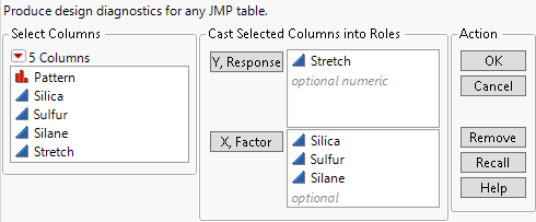

Launch the Evaluate Design platform by selecting DOE > Design Diagnostics > Evaluate Design.
Figure 16.3 Evaluate Design Launch Window
For more information about the options in the Select Columns red triangle menu, see “Column Filter Menu” in Using JMP. The Evaluate Design launch window contains the following options:
Y, Response
Enter the response column or columns. Entering a response is optional. Response values are not used in evaluating the design. Responses must be numeric.
X, Factor
Enter the factor columns. Factors can be of any Data Type or Modeling Type.
