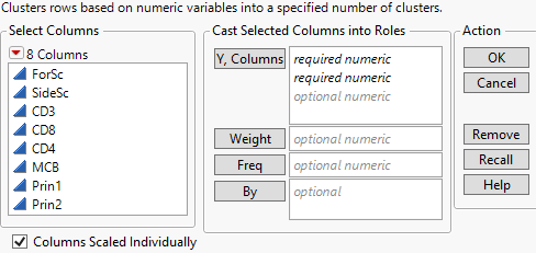

Launch the K Means Cluster platform by selecting Analyze > Clustering > K Means Cluster.
Figure 14.6 K Means Cluster Launch Window

Y, Columns
The variables used for clustering observations.
Note: K-Means clustering supports only numeric columns.

Columns Scaled Individually
Scales each column independently of the other columns. Use when variables do not share a common measurement scale, and you do not want one variable to dominate the clustering process. For example, one variable might have values that are between 0 and 1000, and another variable might have values between 0 and 10. In this situation, you can use the option so that the clustering process is not dominated by the first variable.
