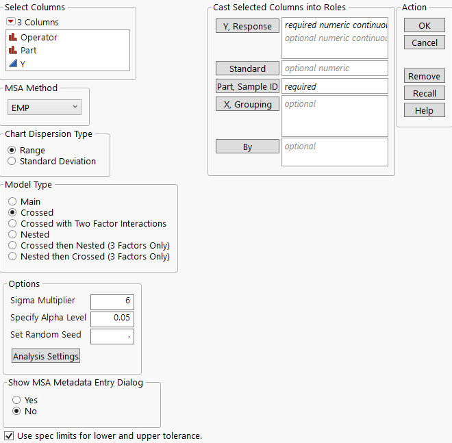

Launch the Measurement Systems Analysis platform by selecting Analyze > Quality and Process > Measurement Systems Analysis.
Figure 4.5 The Measurement Systems Analysis Window
For more information about the options in the Select Columns red triangle menu, see “Column Filter Menu” in Using JMP.
The Measurement Systems Analysis window contains the following features:
Select Columns
Lists all of the variables in your current data table. Move a selected column into a role.
MSA Method
Select the method to use: EMP (Evaluating the Measurement Process), Gauge R&R, or Type 1 Gauge. This chapter covers the EMP method. For more information about the Gauge R&R method, see “Variability Gauge Charts”. For more information about the Type 1 Gauge method, see “Type 1 Gauge Analysis”.
Chart Dispersion Type
Designates the type of chart for showing variation. Select the Range option or the Standard Deviation option.
Note: For the EMP method, the chart dispersion type determines how the statistics in the EMP Results report are calculated. If the Range option is selected, and you have a one factor or a two factor, balanced, crossed model, the statistics in this report are based on ranges. Otherwise, the statistics in this report are based on standard deviations.
