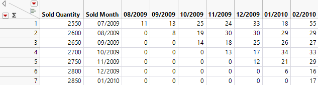

Nevada Format
Contract data is commonly stored in the Nevada format: shipment or production dates and failure counts within specified periods are shaped like the state of Nevada. Figure 10.8 shows the Small Production.jmp sample data table.
Figure 10.8 Example of the Nevada Format

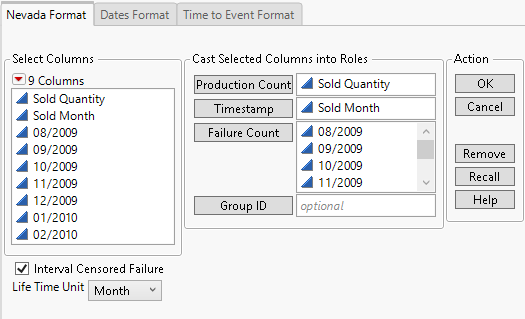

The Nevada Format tab contains the following options:
Interval Censored Failure
Specifies that returned quantities be treated as interval-censored observations. The interval is between the last recorded time and the time that the failure was observed. This option is selected by default.
Life Time Unit
Specifies the physical date-time format of all time stamps, including the format of the column titles for the return counts. This setting is used in forecasting step increments.
Production Count
Column that identifies the number of units produced.
Timestamp
Column that contains the production date.
Failure Count
Column that contains the number of failed units.
Group ID
Column by which observations are grouped. Each group has its own distribution fit and forecast. A combined forecast is also included.

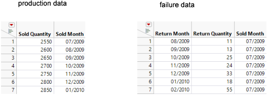

Dates Format
The Dates format focuses on production and failure dates. One data table specifies the production counts for each time period. The other table provides failure dates, failure counts, and the corresponding production times of the failures.
Figure 10.9 shows the Small Production part1.jmp and Small Production part2.jmp sample data tables.
Figure 10.9 Example of the Dates Format

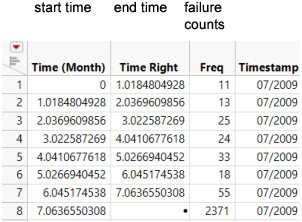

Time to Event Format
The Time to Event format shows production and failure data. Unlike the Nevada and Dates formats, Time to Event data does not include date-time information, such as production or failure dates. This format can also accommodate arbitrary censoring schemes in the data. See Defining Risk Sets with Time to Event Data.
Figure 10.10 shows the Small Production Time to Event.jmp sample data table. For an example that uses time-to-event data, see Additional Example of the Reliability Forecast Platform.
Figure 10.10 Example of the Time to Event Format
The Time to Event Format tab contains the following options:
Forecast Start Time
Specifies the time at which the forecast begins. Enter the first value that you want on the horizontal axis. To enable forecasting, you must select Numeric for the Life Time Unit and set the Forecast Start Time to zero.
