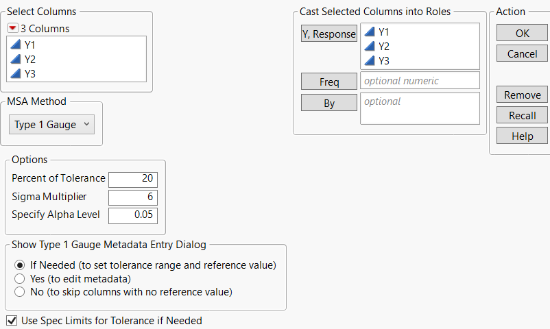

Launch the Type 1 Gauge platform by selecting Analyze > Quality and Process > Measurement Systems Analysis. Set the MSA Method to Type 1 Gauge.
Figure 5.4 The Type 1 Gauge Launch Window
For more information about the options in the Select Columns red triangle menu, see “Column Filter Menu” in Using JMP.

Percent of Tolerance
Specifies the percent of part tolerance used to compare against the measurement variation. The default value is 20%. The percent of tolerance value is used to calculate the portion of tolerance lines plotted on the Run Chart and certain statistics in the Summary and Capability Statistics table.
Sigma Multiplier
Specifies a constant value that is multiplied by sigma. The default value is 6, which means you are looking at 6*sigma or a 6 sigma process.
Specify Alpha Level
Specifies the alpha level for the Bias Test. The default value is 0.05.
Show Type 1 Gauge Metadata Entry Dialog
Specifies when the Type 1 Gauge Metadata dialog is shown after you click OK. This dialog enables you to load the metadata from a data table or enter the metadata for each column manually. When you enter the metadata manually, you can specify a tolerance range directly or specify lower and upper tolerance values. If you choose to enter lower and upper tolerance values, the tolerance range is calculated as the difference between the upper and lower tolerance values. If only one tolerance value is entered, the tolerance range cannot be calculated and any statistics in the report that rely on the tolerance range are not shown. The dialog also contains fields for the reference value and the gauge resolution. Specifying a value for the gauge resolution is optional, but the reference value is required. If a reference value is not entered for a response column, no Type 1 Gauge report is shown for that response column.

If Needed
Opens the Type 1 Gauge Metadata window if at least one of the response columns is missing the tolerance range (or upper and lower tolerance values) or reference value in the MSA column property.
Yes
Opens the Type 1 Gauge Metadata window.
No
Does not open the Type 1 Gauge Metadata window. Columns that do not contain a reference value in the MSA metadata column property are not included in the analysis report.
Use Spec Limits for Tolerance if Needed
If a tolerance range is not specified for a column, but the column has a Spec Limits column property, this option uses the specification limits to calculate the tolerance range.
