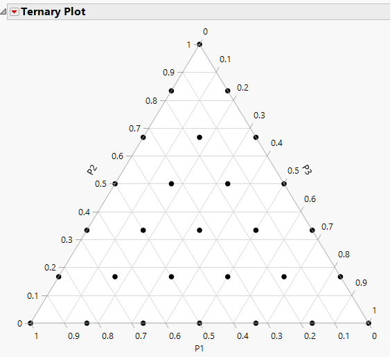

Because the mixture components are proportions that sum to one, the feasible region of a mixture design takes the form of a simplex. For example, a three factor deign can be visualized with a triangular 2-D graph and a four factor design can be visualized with a 3-D tetrahedron.
Figure 14.1 Ternary Plot
Ternary Plot
