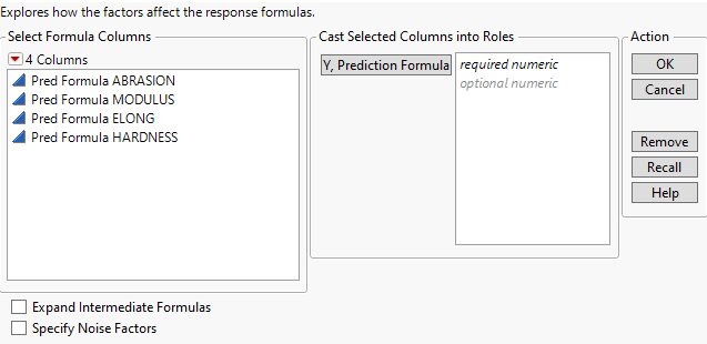

When a profiler is launched directly from the Graph menu, you provide columns with formulas as the Y, Prediction Formula columns. Often, these formulas have been saved from a fitting platform.
Figure 2.2 Profiler Launch Window
For more information about the options in the Select Columns red triangle menu, see “Column Filter Menu” in Using JMP.
The columns referenced in the formulas become the X columns (unless the column is also a Y).
The response columns containing formulas.
Note: You can also add columns that contain the formula and the values for the standard errors of the corresponding response columns. These columns are used to create confidence intervals. The formula columns must be named PredSE <colname>. After you click OK, specify whether you want to use PredSE <colname> to construct confidence intervals for Pred Formula <colname>. Otherwise, JMP creates a separate profiler plot for PredSE <colname>.
Expand Intermediate Formulas
Tells JMP that if an ingredient column to a formula is itself a formula column that refers to other columns, to substitute the original columns into the inner formula. To prevent an ingredient column from expanding, add an Other column property, name it Expand Formula, and assign a value of 0. See Expand Intermediate Formulas.
Specify Noise Factors
Used only in special cases for modeling derivatives. If you select this option and click OK in the launch window, you are prompted to specify noise factors from the formula ingredient columns. For more information about noise factors, see Noise Factors.
