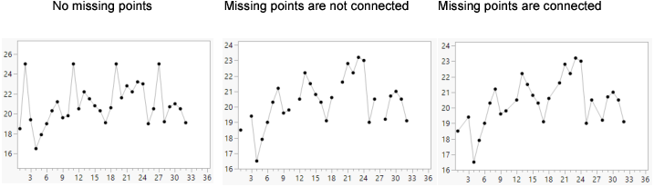

Connect Through Missing
Connects points when some samples have missing values. In Figure 14.11, the left chart has no missing points. The middle chart has samples 2, 11, 19, and 27 missing with the points not connected. The right chart appears if you select the Connect Through Missing option, which is the default.
Figure 14.11 Example of Connected through Missing Option

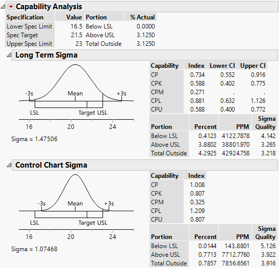

Capability
(Not available when a Phase variable is specified.) Performs a Capability Analysis for your data. A pop-up window is first shown, where you can enter the Lower Spec Limit, Target, and Upper Spec Limit values for the process variable.
Figure 14.12 Capability Analysis Window
An example of a capability analysis report is shown in Figure 14.13 for Coating.jmp when the Lower Spec Limit is set as 16.5, the Target is set to 21.5, and the Upper Spec Limit is set to 23.
Figure 14.13 Capability Analysis Report for Coating.jmp
For additional information, see Statistical Details for Capability Analysis.
