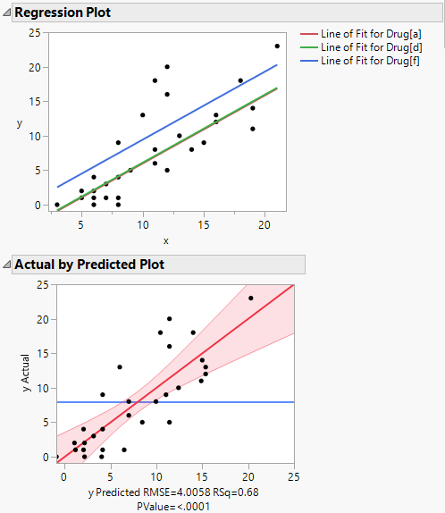

Use the Regression and Actual by Predicted Plots to assess the model and to understand the impact of the covariate on the response.
Figure 4.20 Plots for Analysis of Covariance with Equal Slopes
The Regression Plot shows that you have fit a model with equal slopes. The response increases with the covariate x at equal rates for each drug. Across the levels of the covariate x, the response is highest for Drug f.

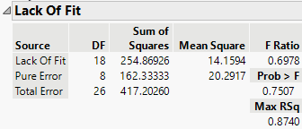

The drug data table contains replicated observations. For example, rows 1 and 9 both have Drug = a and x = 11. When fitting models, replicated observations can be used to construct a pure error estimate of variation. Another estimate of error can be constructed for unspecified functional forms of covariates, or interactions of nominal effects. These estimates form the basis for a lack of fit test. If the lack of fit error is significant, this indicates that there is some effect in your data not explained by your model. See “Lack of Fit”.
Figure 4.21 Analysis of Covariance with Equal Slopes Lack of Fit Test
The Lack of Fit report shows that the lack of fit error is not significant, as seen by the Prob > F value of 0.7507.

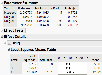

The least squares means differ from the ordinary means because they are adjusted for the effect of the covariate on the response. The least squares means are values that are predicted for each of the three levels of Drug, with the covariate, x, held at its mean value of 10.7333.
The least squares means are calculated using the parameter estimates given in the Parameter Estimates report:
Prediction Expression:
-2.696 - 1.185*Drug[a] - 1.0761*Drug[d] + 0.98718*x
For a:
-2.696 - 1.185*(1) -1.0761*(0) + 0.98718*(10.7333) = 6.71
For d:
-2.696 - 1.185*(0) -1.0761*(1) + 0.98718*(10.7333) = 6.82
For f:
-2.696 - 1.185*(-1) -1.0761*(-1) + 0.98718*(10.7333) = 10.16
