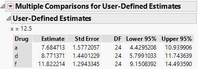

The User-Defined Estimates report shows least square means estimates for each level of Drug with the covariate x set to 12.5. The Multiple Comparisons for User-Defined Estimates red triangle menu contains options that enable you to test for differences among the estimates.
Figure 4.24 User-Defined Estimates Report

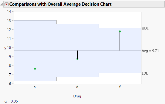

7. Select Comparisons with Overall Average from the Multiple Comparisons for User-Defined Estimates red triangle menu.
Figure 4.25 Comparisons with Overall Average Decision Chart
The Comparisons with Overall Average option shows an analysis of means (ANOM) chart for differences between the average and the three least squares means. From the ANOM chart, you conclude that there is not a significant effect of Drug on the response at x = 12.5.
