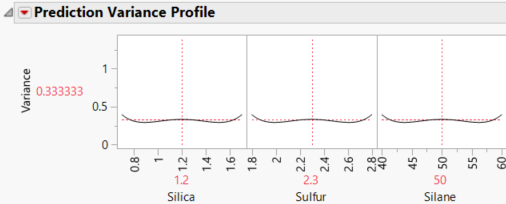

Prediction Variance Profile
In the Evaluate Design report, the Prediction Variance Profile helps you to understand where in the design space your predictions have more or less variability. The Prediction Variance Profile plots the relative variance of prediction as a function of each factor at fixed values of the other factors. See Relative Prediction Variance.
Low prediction variance throughout the design space is desired. Generally, the error variance drops as the sample size increases. When comparing designs, the design with the lower average prediction variance is preferred.
Select the Maximize Variance option from the Prediction Variance Profile red triangle menu to identify the design setting with maximum variance. The value of the maximum variance in the Prediction Variance Profile is the worst (least desirable from a design point of view) value of the relative prediction variance. The maximum variance can occur at more than one combination of factor settings. To evaluate the prediction variance using a surface, see Prediction Variance Surface.
Figure 16.9 Prediction Variance Profiler
