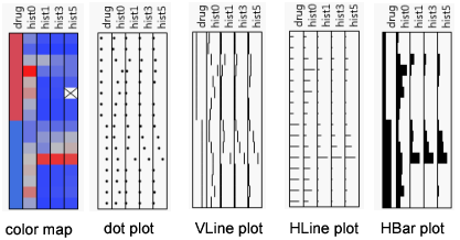

Change the Graph Type
Use the Graph Type option to change the appearance of the cell plot.
Figure 8.5 Graph Types
Graph Types
