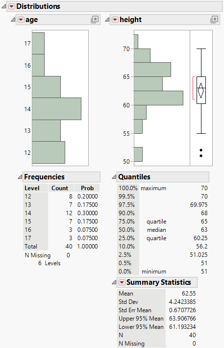

The initial Distribution report contains a histogram and reports for each variable.
Figure 3.5 The Initial Distribution Report Window
Note: Follow the instructions in Example of the Distribution Platform to produce the report shown in Figure 3.5.

Histograms visually display your data. See Histograms.
The initial report for a categorical variable contains a Frequencies report. See The Frequencies Report.
The initial report for a continuous variable contains a Quantiles and a Summary Statistics report. See The Quantiles Report and The Summary Statistics Report.
