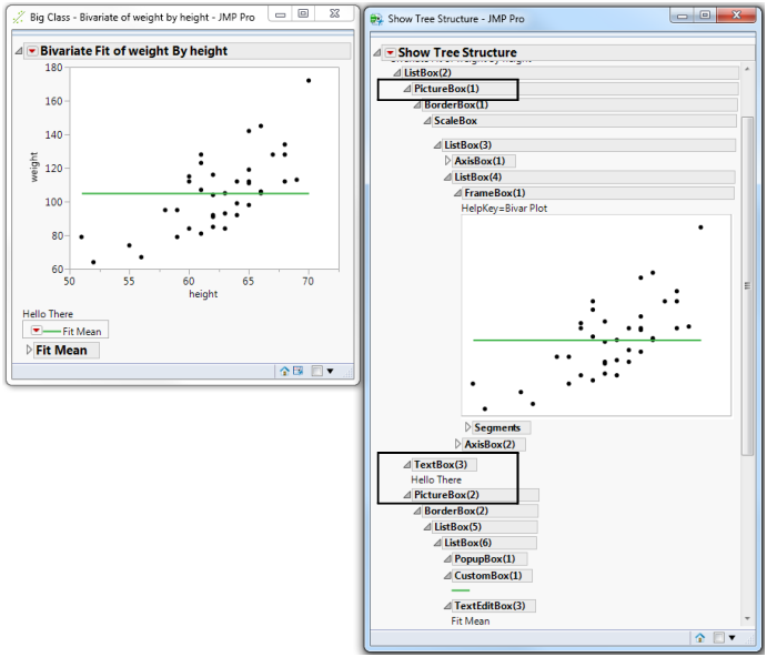

Sib Append
You can use the Sib Append message to add a display box immediately after an existing display box. 图 11.23 shows two picture box trees. Picture Box( 1 ) holds the Bivariate scatterplot. Picture Box( 2 ) holds the Fit Mean menu, determined by seeing the green line and the Fit Mean text box.
Suppose you wanted to insert a text box in between these two boxes. You want to append a sibling to Picture Box( 1 ), so you send it the Sib Append message:
biv = dt << Bivariate(
	Y( :weight ),
	X( :height ),
	Fit Mean( {Line Color( {57, 177, 67} )} )
/* the report function takes the biv object and returns a report object.
append the text box immediately after the first picture box */
Report( biv )[Picture Box( 1 )] << Sib Append( Text Box( "Hello There" ) );
Figure 11.23 Appending a Sibling Text Box
Note: In 图 11.23, the appended sibling text box appears below the first picture box in the Show Tree Structure View window. In the classic Show Tree Structure View window, siblings appeared next to each other in the display tree. See Show the Display Tree.

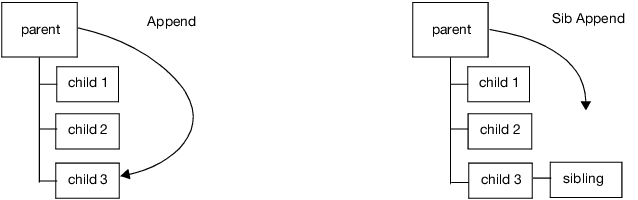

图 11.24 shows the difference between and Append() and Sib Append(). Append() makes the display box a child of the parent display box. Sib Append() makes the display box a sibling of the last display box.
Figure 11.24 Append (Left) and Sib Append (Right)
Note: If the parent display box is not a V List Box(), Sib Append() wraps that display box in V List Box().
