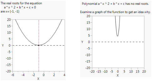

Clicking OK, displays a results window (图 11.33, left), with either the roots or an error message. Rerun the script, input 5, 4, and 5 respectively and click OK. Note that JMP displays an error message (图 11.33, right).
Figure 11.33 The Custom Platform’s Report
