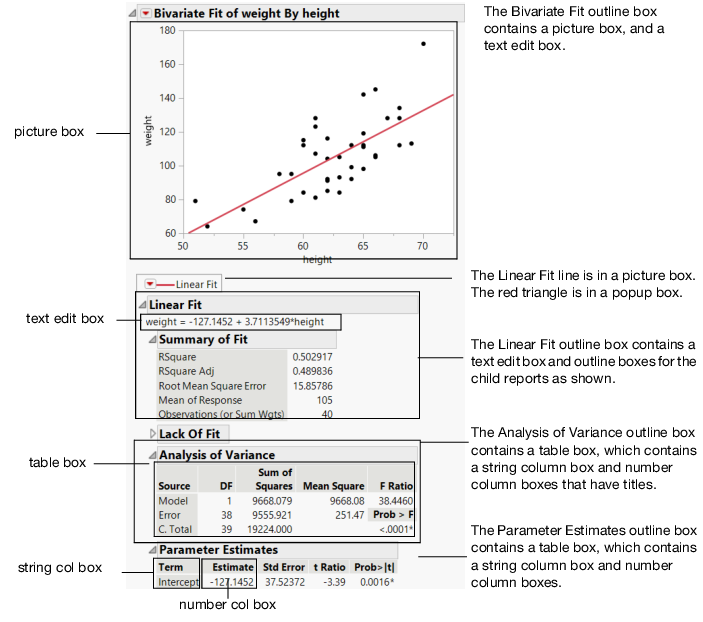

图 11.1 shows a Bivariate report that consists of several common display boxes.
Figure 11.1 Display Boxes in a Report
Run the following script to create the report:
biv = dt << Bivariate( Y( :weight ), X( :height ), Fit Line() );
