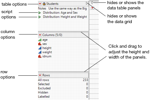

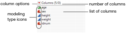

These panels are located on the left of the data grid. They contain information about the table and its contents. Each panel has interactive areas. See Interacting with the Data Table Panels.
Creates a new table variable, which can be text or any other constant character value that you always want to be available in the data table. Table variables are normally used to document tables. See Use Table Variables in Enter and Edit Data for more information.
Creates a JSL script to save with the data table. After selecting this command, name the script and type in the value (the JSL commands). After you click OK, the new script is listed in the Table panel and you can click its red triangle menu to run, edit, or delete it. See Create and Save Scripts in Enter and Edit Data.
Locks the data table so that data and column properties cannot be edited or added. You can still run analyses, assign characteristics, add rows and columns, and so on. See Lock Tables in Enter and Edit Data.
Compresses the data table when it is saved. After the data table is saved, a compressed file icon
appears next to the data table name in the table panel. See Compress Tables in Enter and Edit Data.
The Compress file when saved option only decreases the file size. This command does not affect the memory required to analyze the data. To reduce both the file size and memory required for analyzing, use Cols > Utilities > Compress Selected Columns. See Compress Selected Columns in Enter and Edit Data.
Tip: You can also configure JMP to always use GZ compression when saving tables by selecting Preferences > General > Save Data Table Columns GZ Compressed.

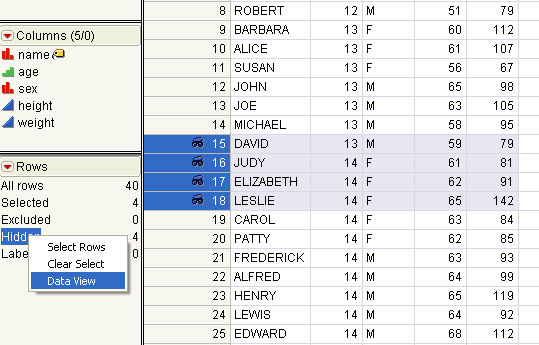

Right-click the categories in the Rows panel to select rows, clear the selection, or to create a data view.
A data view creates a linked subset of the main data table. For example, if several rows are marked hidden, you might want to open a window that shows you only the hidden rows. Right-click Hidden in the Rows panel and select Data View.
