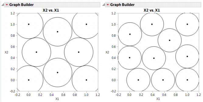

The Space Filling platform provides designs for situations with both continuous and categorical factors. For continuous factors, space-filling designs have two objectives:
maximize the distance between any two design points
space the points uniformly
