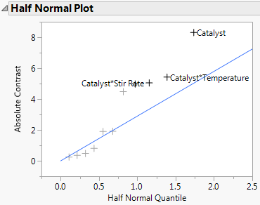

Half Normal Plot from Fit Two Level Screening Report
