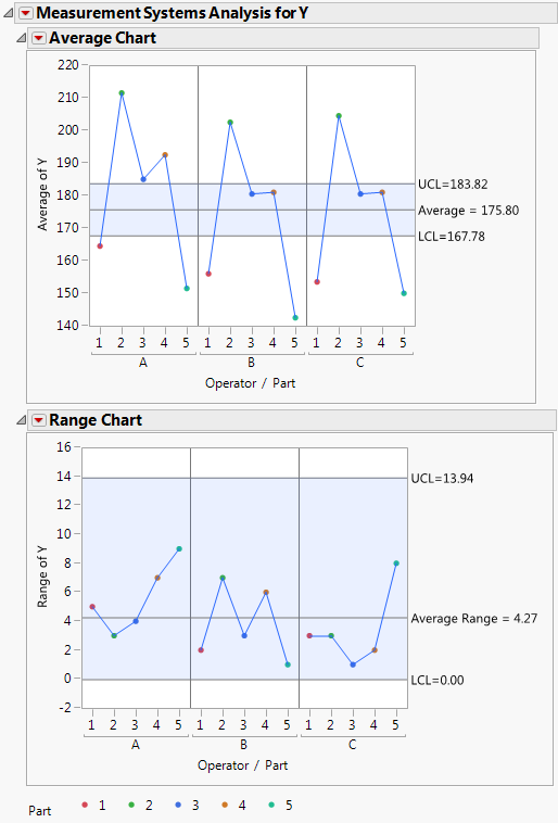

Figure 7.1
Example of a Measurement System Analysis
