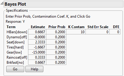

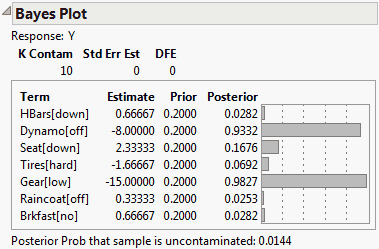

The specifications window, showing default settings for a Bayes Plot for the Bicycle.jmp sample data table, is shown in Figure 2.46. Clicking Go in this window updates the report to show Posterior probabilities for each of the terms and a bar chart (Figure 2.47).

Figure 2.46 Bayes Plot Specifications

Click Go to calculate the posterior probabilities.
Figure 2.47 Bayes Plot Report
