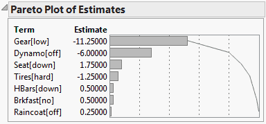

The Pareto Plot report presents a Pareto chart of the absolute values of the estimates. Figure 2.48 shows a Pareto Plot report for the Bicycle.jmp sample data table.
If the original estimates have unequal variances and are not correlated, the t ratios are plotted.
Note: The estimates that appear in the plot are standardized to have equal variances and are transformed to be orthogonal. You have the option of undoing these transformations. See Transformations.
Figure 2.48 Pareto Plot
