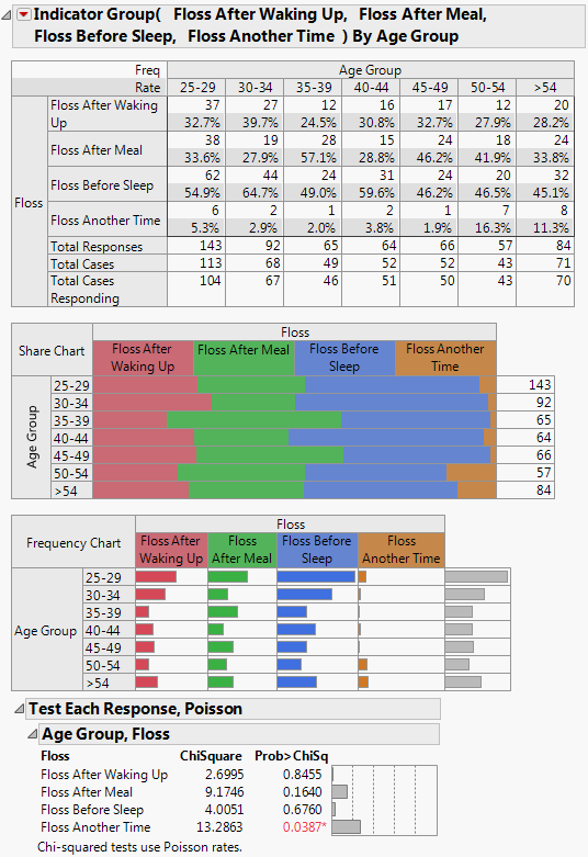

The Categorical platform enables you to tabulate, plot, and compare categorical response data, including multiple response data. You can use this platform to analyze data from surveys and other categorical response data, such as defect records and study participant demographics. With the Categorical platform you can analyze responses from a rich variety of organizations of data. The Categorical launch window enables you to specify analyses as well as data formats.
Figure 4.1
Categorical Analysis Example
Example of the Categorical Platform
