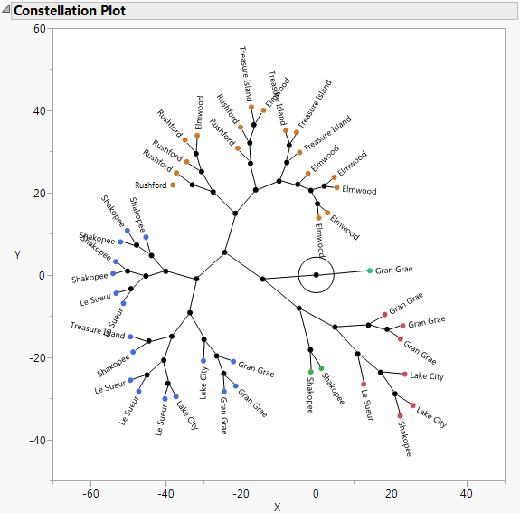

Figure 10.1
Example of a Constellation Plot
