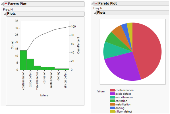

Improve the statistical quality of your process or operation using Pareto plots. A Pareto plot is a chart that shows severity (frequency) of problems in a quality-related process or operation. Pareto plots help you decide which problems to solve first by highlighting the frequency and severity of problems.
Figure 11.1
Pareto Plot Examples
