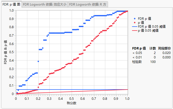

图 24.1 响应筛选图的示例
Example of a Response Screening Plot
